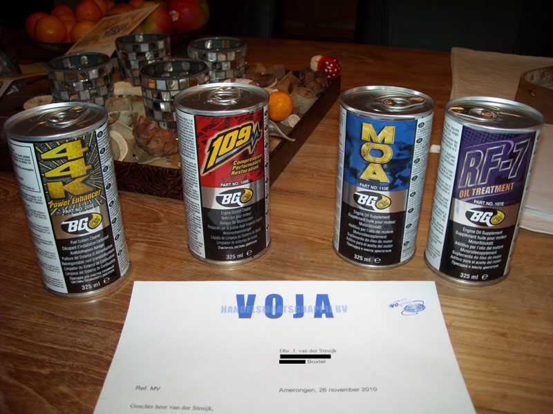

Even een update hiero.
Afgelopen weekend kreeg ik een pakketje binnen met daarin 4 producten, aangeleverd door BG importeur VOJA:
BG 44K
"BG 44K® Power Enhancer® safely, rapidly and thoroughly removes engine deposits in combustion chambers, intake manifolds, ports and on valves. It restores flow in fuel injectors and cleans the entire fuel system. BG 44K® Power Enhancer® improves fuel economy and reduces exhaust emissions. It restores that “like new” driveability to an engine’s performance and keeps it running better, longer and more efficiently. Add one can or bottle to fuel tank at fill up. Catalytic converter and oxygen sensor safe."
BG 109
"BG 109 Compression Performance Restoration is a revolutionary formula with proven “ring-clean” technology. It is a quick and effective blend of cleaners that will soften, emulsify and dissolve those hard to remove fuel gums that clog rings and will usually do it in 15 minutes or less. Compression will increase with removal of these deposits. BG 109 also lowers tailpipe emissions, eliminates oil consumption associated with buildup and improves overall power and economy. Safe for use in diesel and rotary engines."
BG MOA
"BG MOA® prevents oxidation and thickening of engine oil under even the most severe stop-and-go, high temperature driving conditions. It fortifies all qualities of engine oil to provide superior long-lasting engine protection and helps maintain optimum engine performance. BG MOA® keeps piston ring belts, hydraulic lifters and other engine components clean to help extend engine life and reduce costs of operation. It is compatible with both synthetic and petroleum-base oils. The Thin Film Oxidation Uptake Test (TFOUT), ASTM Test Method D4742, proves BG MOA’s remarkable resistance to oxidation by more than 200% longer than six major brands of SL quality oil. At the conclusion of the API Sequence IIIF Engine Test‚ a major brand, high-quality reference oil barely passed the 80-hour test with a viscosity increase of 255 percent. At 80 hours, another brand of oil fortified with BG MOA® had a viscosity increase of only 57 percent. At the conclusion of the triple-length, 240-hour test, it was still well within the viscosity limits with an increase of only 198 percent."
BG RF-7
BG RF-7 is a specially developed formula for engine oil which helps increase engine compression and power by increasing the viscosity of the oil. It also helps seal rings to increase compression and reduce blow-by. BG RF-7 contains additives which keep the engine oil from oxidizing or thickening, and it protects internal parts from corrosive damage. It will help reduce oil consumption and exhaust smoke and will reduce lifter and valve noise. BG RF-7 is compatible with both synthetic and petroleum-base oils.
Gisteren heb ik het eerste product BG 44K toegevoegd aan een volle benzinetank. Ik ben benieuwd en houd jullie op de hoogte van mijn ervaringen.
De overige producten hebben betrekking op de olie en staat binnenkort op de planning om uit te voeren. Als eerste moet ik de 109 toevoegen aan de huidige olie en zo een half uur laten draaien zodat het product zijn werk kan doen. Vervolgens de olie niet laten afkoelen maar direct de olie aftappen en de oliefilter vervangen. Voeg nu eerst de MOA en RF-7 toe en vul dan af met nieuwe olie.
Dit alles moet resulteren in een rustiger lopende motor, aanzienlijk minder olieverbruik en als het goed is ook winst in het benzineverbruik door de soepeler lopende motor.
Ook hierover horen jullie uiteraard meer van mij. ;)
