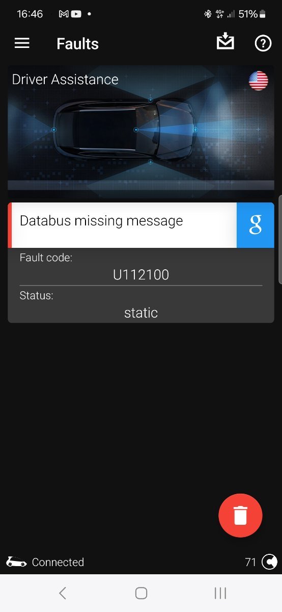

    Trouble codes:
        U112100 - Databus missing message
            static
                Date: 2105-12-16 21:30:32
                Mileage: 160910 km
                Priority: 6
                Malfunction frequency counter: 1
                Unlearning counter: 243

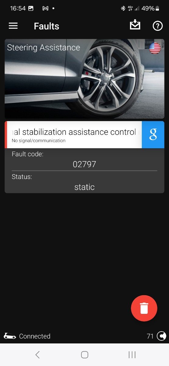

44 Steering Assistance
    System description: J500__APA-BS KL.300
    Software number: 5N1909144R
    Software version: 1401
    Hardware number: 5N1909148J  *
    Hardware version: H04
    Serial number: 00151870015001
    Coding: 0000258
    Trouble codes:
        02797 - Directional stabilization assistance control module No signal/communication
            Intermittent
                Priority:  6
                Frequency counter:  9
                Driving cycle: 30
                Mileage: 160910 km

    Trouble codes:
            static
                Date: 2105-12-16 21:30:34
                Mileage: 160910 km
                Priority: 6
        U112300 - Databus error value received
            static
                Mileage: 160910 km
                Priority: 6
                Malfunction frequency counter: 18
                Unlearning counter: 246

    Trouble codes:
        B201000 - No basic setting
            static
                Date: 2105-12-16 21:30:50
                Mileage: 160910 km
                Priority: 4
                Control module temperature: 31 °C
                Vehicle speed: 0.00 km/h
                Voltage terminal 15: 14.3 V
                Outside air temperature: 5.5 °C
                System run time: 1920.0 s
                Status of camera: System malfunction
                Engine_Running_Info: 1
                MID: 001E
                Software_Info_1: 0
                Software_Info_2: 0
                Software_Info_3: 1
                Software_Info_4: 0
            static
                Mileage: 160910 km
                Priority: 6
                System run time: 1920.4 s
                MID: 01A9
                Software_Info_1: 0
                Software_Info_2: 0
                Software_Info_3: 1
                Software_Info_4: 0
            static
                Date: 2105-12-16 21:30:51
                Mileage: 160910 km
                Priority: 6
                System run time: 1921.3 s
                MID: 01F7
                Software_Info_1: 0
                Software_Info_2: 0
                Software_Info_3: 1
                Software_Info_4: 0
In de uitdraai is duidelijk te zien dat de camera wel bereikbaar is. Er is sowieso een calibratie nodig gezien de "no basic setting" fout. Waarom de ruitenfirma de camera niet kon bereiken is me een raadsel.
Misschien dat @Passat Rdi hier een oplossing voor kent gezien hij meer ervaring heeft met de calibratie van deze camera's
